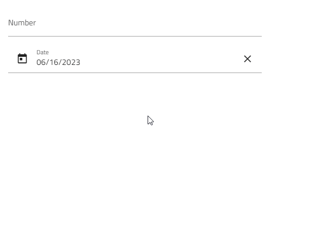

    The described scenario could be observed here where I scroll in both components but as you can see nothing happens:
