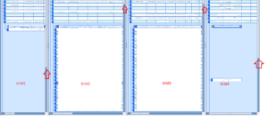

        I'm sorry for not replying during thees months. Please see screenshot below:
        In above screenshot, you can see that I have four grids and I have succeeded to keep them in sync for many events, such as when you expand a parent row, all rows in the same line will be expanded(as I said the parent level data structure is same).
        You might notice that the four scroll bars(pointed by RED arrows) are NOT in same size, which means they have different sizes of scroll regions. It seems to that this is only controlled by the number of visible rows. So I still have the following questions after nearly a years straggling.
        1.Does Infragistics allow user to override this?
        2.If you DO allow above, please kindly show me the idea.
        3.If NOT, is there any suggestion according to the version(V14.2) I'm currently using.

      Grand Gao answered on Apr 6, 2017 3:36 AM
      Sorry. I just updated this topic and uploaded a new screenshot. Please take a look. Thanks.

        Yes, you are correct. The size of the scrollbar depends on the number of visible rows. And there is no way to control this by setting any public property or call a method of the grid. What I can suggest you, to synchronize the scrolling of the grids is to try to set the FirstRow of your RowScrollRegions to the row you need to be at the top of the visible rows.
        Please let me know if this solves your issue.
