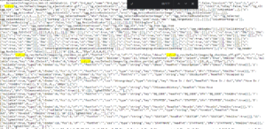

        For View State Issue, When setting EnableAjaxViewState and EnableDataViewState properties as false on the Grid, the existing functionalities of Grid such as Editor Providers assigned to columns are not appearing in the Grid. We are binding DataSet to the grid server side.
        Please find the attached screenshot for WebDataTree containing ../ in “res” parameter.

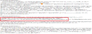

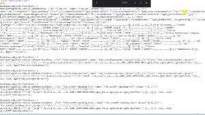

        Kindly let us know on the below for Directory Traversal Issue.
        “../” is not changed even after moving ig_res folder to  the directory where the page resides for one particular post variable “res”.
        Please find the attached screenshot for reference.
        Changes made in the code:
        Reflection in Response:
        The inference is that “../” in res variable in the response is not for StyleSetPath and is used for some other purpose. Image paths are not shown in the control if the images are within the folder itself.
        What is the content that is getting accessed (requiring directory traversal) by this entry in the post value?
        And is there a way that this directory traversal can be avoided, by using any relevant property for the control – similar to StyleSetPath property for WebDataTree control?
