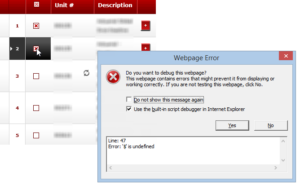

I have an unbound checkbox, template field (with button) and a couple of bound fields.
The grid has AJAX enabled.
Load the data on postback using WebHierarchicalDataSource in code behind.
Check the checkbox of a row = ok
Check the checkbox or another row, a post back occurs and get the error blow.
The Behaviors that are enabled:
  • Editing Core – Cell Editing (to allow checkbox to be checked)
  • Row Selectors – showing row number
  • Selection- Full Row
ERROR
Message: Exception of type ‘System.Web.HttpUnhandledException’ was thrown.
Source: System.Web
Stack trace: at System.Web.UI.Page.HandleError(Exception e) at System.Web.UI.Page.ProcessRequestMain(Boolean includeStagesBeforeAsyncPoint, Boolean includeStagesAfterAsyncPoint) at System.Web.UI.Page.ProcessRequest(Boolean includeStagesBeforeAsyncPoint, Boolean includeStagesAfterAsyncPoint) at System.Web.UI.Page.ProcessRequest() at System.Web.UI.Page.ProcessRequestWithNoAssert(HttpContext context) at System.Web.UI.Page.ProcessRequest(HttpContext context) at ASP.maintenancescreens_hewitt_retentionmaintenance_aspx.ProcessRequest(HttpContext context) in C:\Windows\Microsoft.NET\Framework\v4.0.30319\Temporary ASP.NET Files\nettraxnet.dev\70a61a39\76f3f529\App_Web_fz2gmtg0.2.vb:line 0 at System.Web.HttpApplication.CallHandlerExecutionStep.System.Web.HttpApplication.IExecutionStep.Execute() at System.Web.HttpApplication.ExecuteStep(IExecutionStep step, Boolean& completedSynchronously)
Details: System.Web.HttpUnhandledException (0x80004005): Exception of type ‘System.Web.HttpUnhandledException’ was thrown. —> System.NullReferenceException: Object reference not set to an instance of an object. at Infragistics.Web.UI.DataSourceControls.WebHierarchicalDataSource.FindControlRecursive(Control root, String id) at Infragistics.Web.UI.DataSourceControls.WebHierarchicalDataSource.GetOriginalDataSource(String id) at Infragistics.Web.UI.DataSourceControls.WebHierarchicalFlatDataSourceView.get_OriginalDataSource() at Infragistics.Web.UI.DataSourceControls.WebHierarchicalFlatDataSourceView.get_UpdateParameters() at Infragistics.Web.UI.Framework.Data.DataSourceControlAdapter.get_UpdateParameters() at Infragistics.Web.UI.Framework.Data.DataSourceObjectView.get_UpdateParameters() at Infragistics.Web.UI.GridControls.EditingCore.OnAction(String actionType, Object id, Object value, Object tag) at Infragistics.Web.UI.GridControls.GridBehavior.Infragistics.Web.UI.GridControls.IGridBehavior.OnAction(String actionType, Object id, Object value, Object tag) at Infragistics.Web.UI.GridControls.GridBot.LoadAdditionalClientState(Object state) at Infragistics.Web.UI.GridControls.ContainerGridBot.LoadAdditionalClientState(Object state) at Infragistics.Web.UI.Framework.RunBot.HandleRaisePostDataChangedEvent() at Infragistics.Web.UI.GridControls.GridBot.HandleRaisePostDataChangedEvent() at Infragistics.Web.UI.GridControls.ContainerGrid.RaisePostDataChangedEvent() at System.Web.UI.Page.RaiseChangedEvents() at System.Web.UI.Page.ProcessRequestMain(Boolean includeStagesBeforeAsyncPoint, Boolean includeStagesAfterAsyncPoint) at System.Web.UI.Page.HandleError(Exception e) at System.Web.UI.Page.ProcessRequestMain(Boolean includeStagesBeforeAsyncPoint, Boolean includeStagesAfterAsyncPoint) at System.Web.UI.Page.ProcessRequest(Boolean includeStagesBeforeAsyncPoint, Boolean includeStagesAfterAsyncPoint) at System.Web.UI.Page.ProcessRequest() at System.Web.UI.Page.ProcessRequestWithNoAssert(HttpContext context) at System.Web.UI.Page.ProcessRequest(HttpContext context) at ASP.maintenancescreens_hewitt_retentionmaintenance_aspx.ProcessRequest(HttpContext context) in C:\Windows\Microsoft.NET\Framework\v4.0.30319\Temporary ASP.NET Files\nettraxnet.dev\70a61a39\76f3f529\App_Web_fz2gmtg0.2.vb:line 0 at System.Web.HttpApplication.CallHandlerExecutionStep.System.Web.HttpApplication.IExecutionStep.Execute() at System.Web.HttpApplication.ExecuteStep(IExecutionStep step, Boolean& completedSynchronously)

    Please make sure that you have jQuery referenced in your page as this is what the error ($ is undefined) hints. Please let me know the result.

      When the error is thrown, it fails on the client side and the first line happens to be a jQuery call and that is the message that IE displays.  The root of the problem seems to be in the binding, but, why does the grid do a postback when checking a checkbox (there are no event to trigger a postback).  Why the 2nd or 3rd check and not the checked item?

        I ran Fiddler and it’s a reference issue, but, the page loads and it’s not until the second row is checked the error occurs?

        After clicking on the 2nd row (checkbox) there is a postback that occurs:
        link href="ig_res/RedPlanet/ig_shared.css" type="text/css" rel="stylesheet" />
        <link href="ig_res/RedPlanet/ig_dialogwindow.css" type="text/css" rel="stylesheet" />
        The other pattern I see… I can have one item checked.  Uncheck and check another no error, but, once I check 2 rows.  Then a post back occurs.  Not sure why a postback would happen when items are checked on the grid.

        I did a few things:
        1) Cleared the ASP.Net Temp folder
        2) Turned on/off behaviors.
        These seem to have fixed the problem.  For now, I'll consider this item closed unless it comes up again.
