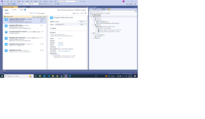

    I totally understand the confusion about the chart packages, here I am trying to explain , so we had ultraChart which is old control and almost retired , ultraChart is been replaced by ultraDataChart which is a new control and comparatively more efficient. We have dlls available for both the controls but for the NuGet we have packages for only UltraDataChart.
    So for UltraDataChart you would need to include chart package which will include dataVisulaization and portable core assemblies. Attached screenshot for the reference.(adding packages from the license feed)
