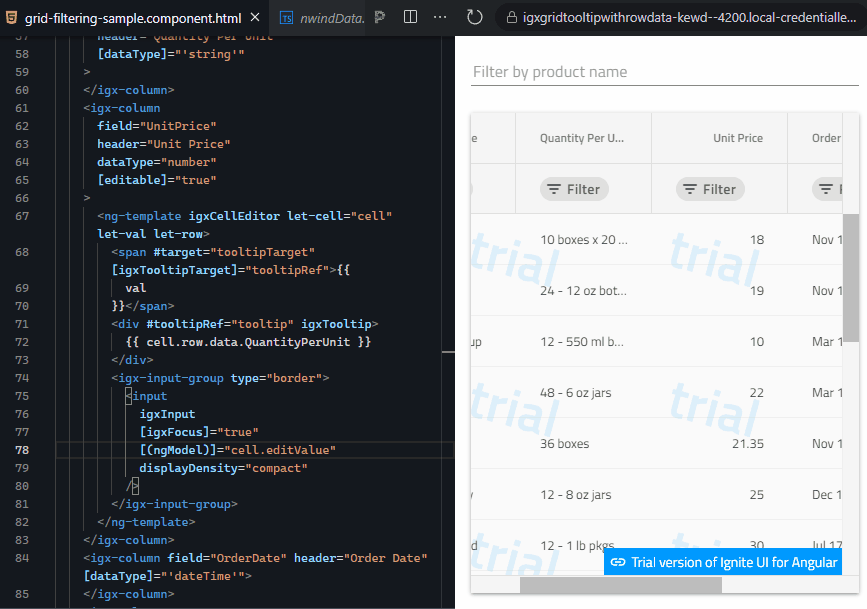

    I have created this sample demostrating how the IgxGrid’s Cell Templating functionality can be leveraged in combination with the IgxTooltip capabilities to easily achieve your requirement.
    The approach involves creating a cell display template that can be as simple as the default one, however, the element displaying the cell value has the addition of being set as a tooltip target. The same could be achieved for the cell editing template, of course. The tooltip reference template itself is defined within this cell template and displays a value from the exposed cell context:
              val
    {{ cell.row.data.QuantityPerUnit }}
    I hope this suggestion helps. If you require any further assistance on the matter, please, let me know.

        I have modified the previously referenced sample to also include a cell editing template with the same span and tooltip elements.
        On my side everything is working as expected as the cell context provides info about the row and its data there as well and the tooltip correctly displays another column’s value. Could I ask you to please have a look at the sample again and eventually compare any discrepancies between it and your own template’s code? The only possible root cause I can currently think of is probably a typo in the data source’s filed name – “createdBy” as you have written.
        Please, keep in mind, though, that I am not really familiar with your data model, such as what a “scenario name” represents, .etc.
        By your description, I was under the impression it is a field in your data. In case I am missing an aspect of your requirement, please, provide further details on the same. If the information you would like to display in a tooltip cannot actually be found in the data record, maybe a getter/public field in the .ts file is indeed what has to be implemented. You could use the cellEditEnter event for instance, to extract information about the currently edited cell and set the value of this variable based on it.

        Thank you for sharing sample code. As far as the current discussion is concerned, I think only the “name” filed and its cell editor template code are relevant in this case, as well as the “scenario” interface having the “active” property.
        At this point, I cannot identify anything wrong about this template. To verify it, I added it to the previously referenced sample’s “UnitPrice” column. By only modifying the accessed data property name to be any of the sample’s data properties, everything is working as expected and the tooltip shows the correct value of the expected data field. Please, check how it behaves in the sample:
        The only thing I am wondering about concerning the code-snippet, is the fact that the “name” field in your grid is not marked as editable and the igxCellEditor sets just the editing template.
        In conclusion, I am afraid I cannot give further suggestions on what else may be missing on your side, given that the isolated sample shows everything working as expected. My suggestion is to debug and verify that the target properties of the data are indeed defined. As usual, forking and modifying the StackBlitz sample to reproduce the behavior will be appreciated, so I can assist you further with the issue.
